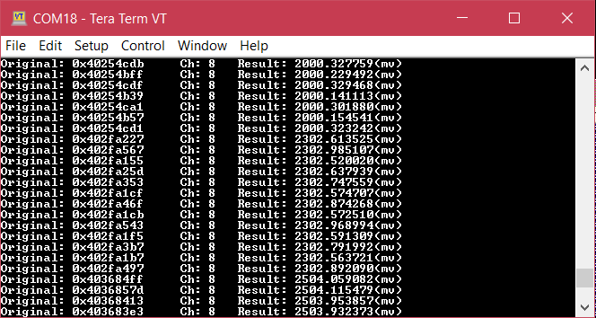

Hi Karim,
I ran the ADC example, and the readings I got were accurate with an error of approximately +-5mV:
Was the ADC reference changed in any way? Or is the example unchanged?
Please let me know if you continue to have issues.
Sebastian
