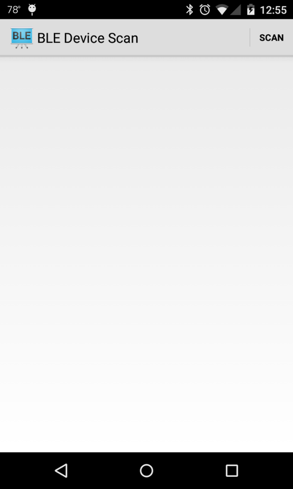

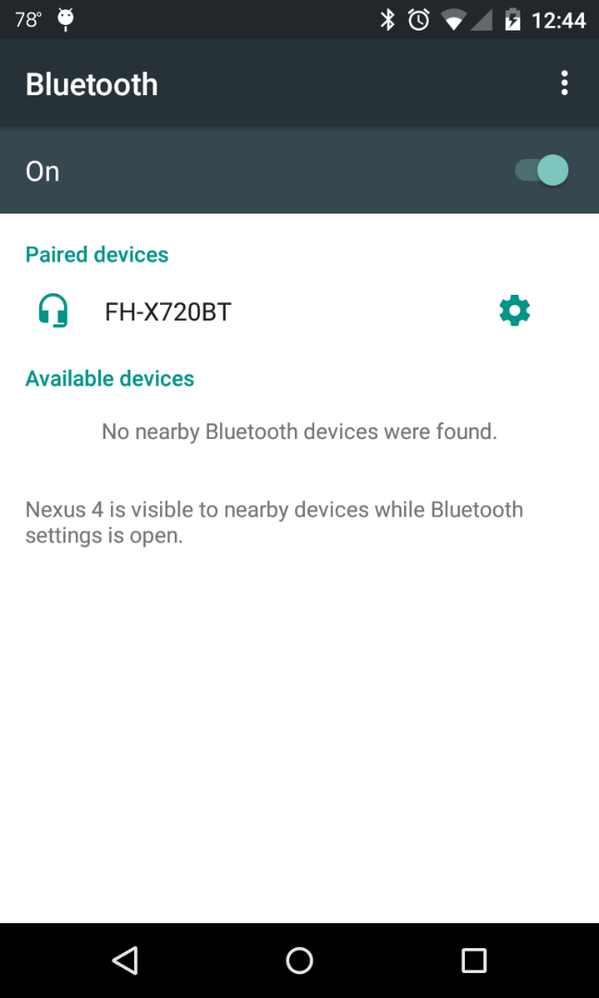

I think that sets up my LED connection and initialization at PTB18. I'm trying to understand how I can detect the advertisement from the board on a custom BLE mobile app. The only way I can see the device from my mobile phone is using the IoT Toolbox app NXP and booting up the Beacon program within. What would I need to modify in the beacon software stack to see the BLE advertisement on a custom BLE mobile app?
I have a template BLE app "BluetoothLeGatt" provided from Android Studios which just does a scan of nearby devices and currently nothing shows up.

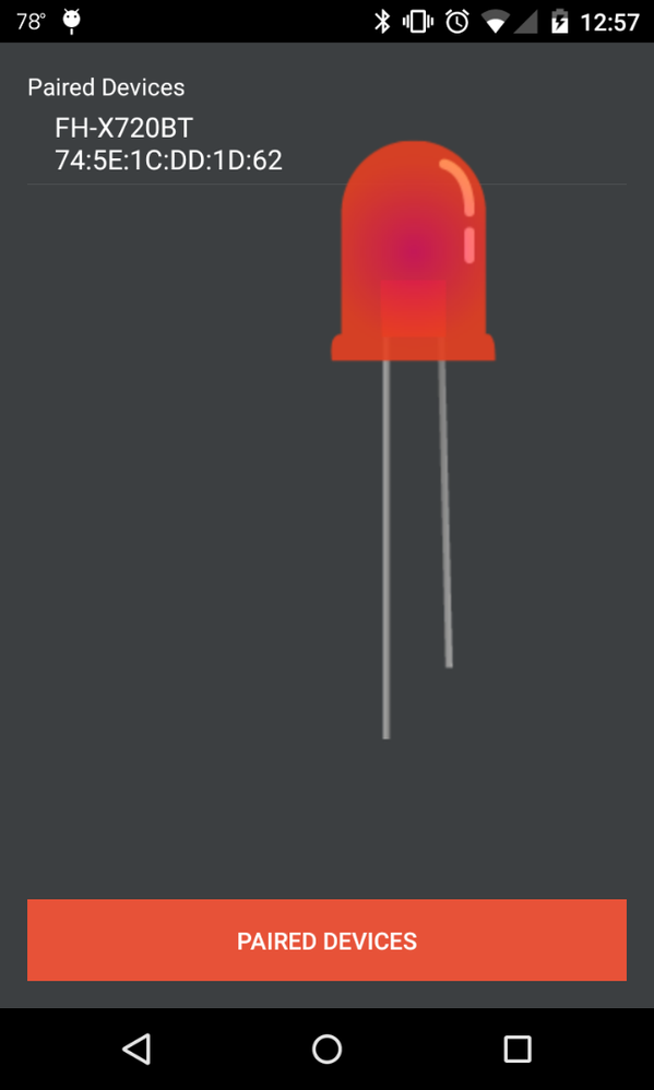

I also have a LEDController Sample App but it first needs to pair to the R41Z device before I can use the on/off functionality.
After I am able to pair the devices the next step would be to read the message of a "HIGH" or "LOW" signal sent from the mobile app.
The functions in the LEDControllerSample app sending these commands are defined as following:
private void turnOffLed()
    if (btSocket!=null)
        try
            btSocket.getOutputStream().write("0".toString().getBytes());
        catch (IOException e)
            msg("Error");
private void turnOnLed()
    if (btSocket!=null)
        try
            btSocket.getOutputStream().write("1".toString().getBytes());
            msg("Error");
Also, in the source code of the mobile app there is this line:
static final UUID myUUID = UUID.fromString("00001101-0000-1000-8000-00805F9B34FB");
Does this UUID need to be changed to the matching R41Z board?

It will depend on your application, as you know the beacon is sending advertisements packets and the central device, in this case, the Phone will only scan that packets without a connection.
  • If using the beacon project, which files should I be looking at modifying for the LED functionality, signal advertising, receiving the message from the phone app, etc.?
Yes, you can create your own custom advertisement packet
  • When it comes to the phone app, are there certain IDs that are within the beacon project that has to be used on the code for the phone app? I see the file BLE_SIG_DEFINES_H has GATT declarations but I'm not too familiar yet how these play a role within the phone app.
The same, it will depend on your custom advertisement, what do you want to send and the way that you will process that information in your app.
  • Does this UUID need to be changed to the matching R41Z board?
it will depend on your phone app, if the application is scanning just that particular UUID, the R41Z should be the same.
