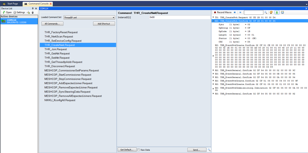

I am trying to get the thread host interface example working.
I have downloaded the SDK from Welcome to MCUXpresso | MCUXpresso Config Tools  and I am trying to run the frdmkw41z_wireless_examples_thread_host_controlled_device_freertos example.
I have flashed it to my frdmkw41z board, which flashes the RGB LED blue. I connected a UART to USB adapter running on COM 4.
I downloaded the NXP Test Tool 12 to test out the THCI functionality. It recognizes the com port. Whenever I send a command, there is a TX entry but no RX response. If I plug the board in when its off, I can see a few RX commands as the board starts up.
Any help would be greatly appreciated.

To try to recreate your issue, could you please tell me which IDE are you using?

I am using the MCUXpresso IDE v10.0.2 [Build 411] [2017-07-11] .

I used the latest version available in the MCUXpresso web page, and I did not have any problem while working with the Test Tool.
Which baud rate are you using?
