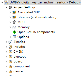

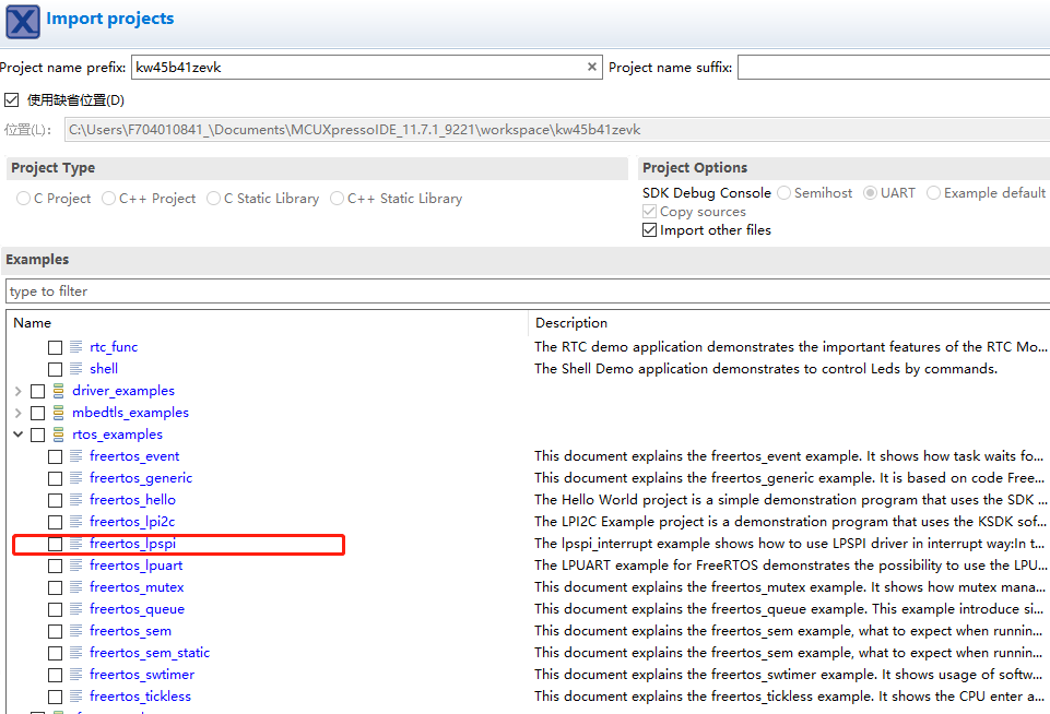

Taiyi
HI !
企业微信截图_16929439857935.png企业微信截图_16929439092241.png企业微信截图_16929437902677.pngThis is the code I ported from the official DEMO "freertos_lpspi", I use the routine "digital_key_car_anchor_freertos" this routine. We now use our own KW45 circuit board to debug the peripheral SPI chip, which must work in half-duplex mode. But we used this SPI code to debug with the slave, and the communication received data was wrong. When communicating with a full-duplex device, data is received and sent normally. Therefore, I would like to consult whether I need to modify the underlying configuration of SPI in half-duplex dual-mode.
