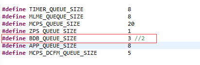

     I added two new dimmer endpoints to the JN-AN-1218-Zigbee-3-0-Light-Bulb routine, and then added all three endpoints to the same group ID. When sending data to this group ID, only two endpoints can receive data at the same time, and the other endpoint can not receive data. Is there restriction on the endpoint number receiving multicast data .

Hi Guomiao,
There is no limitation.
Is all the endpoint discoverable?
Did you capture the packets in the air? Do you have the sniffer log?
Mario

     I changed BDB_QUEUE_SIZE to 3 and it was normal.
