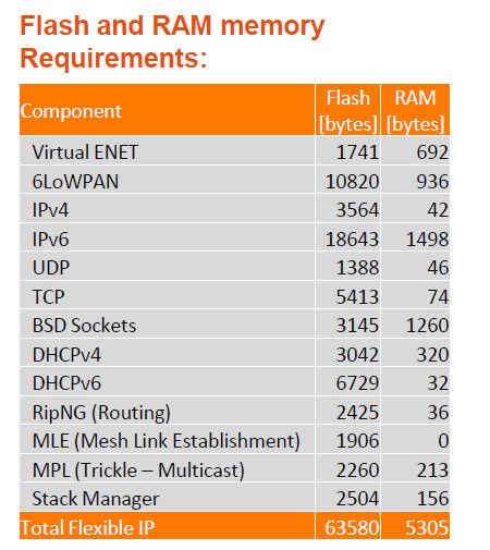

2. KW01Z is too small flash memory size for our application, so I’d like to use additional NXP MCU.
It means I only use RF block of KW01Z and s/w stack will be loaded to additional MCU.
If I use additional MCU + KW01Z, can I get the S/W stack?
