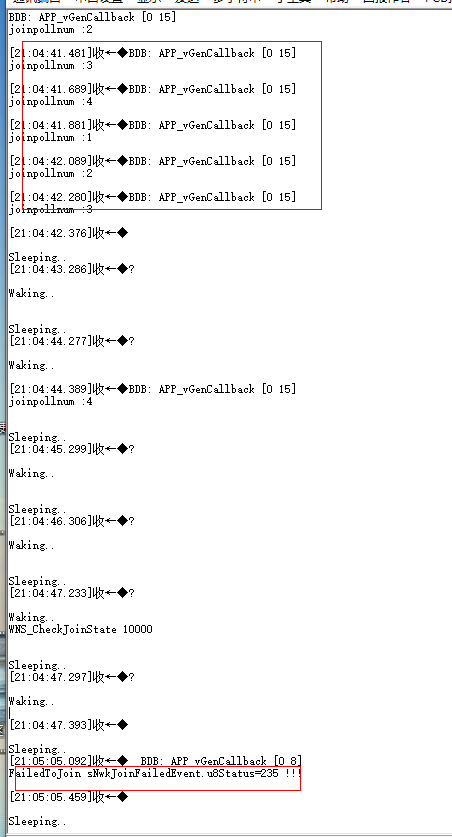

Hi Abel, I hope you're doing well!
The event you're seeing in the APP_vGenCallback print on the console corresponds to a ZPS_EVENT_NWK_POLL_CONFIRM event, meaning that the device successfully polled for information. If you want to reduce the times this message is displayed, you could try reducing awake time, so that the device doesn't poll as much.

iot_abel
Hello Sebastian
We tested it according to your method. Look at the picture below
We use PWRM? Escheduleactivity to sleep, but the system will continue to send data reply after waking up
Is the interface we call wrong?
We want to reduce the number of requests, so as to enter the next channel in advance or the coordinator to scan the network. We test that failedtojoin snwkjoinfailedevent. U8status = 235!!! Then we will enter the next channel. Do we have any way to achieve this?

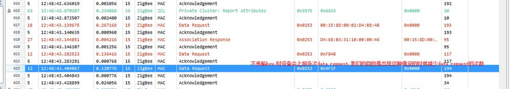

iot_abel
Hi Sebastia
When the coordinator does not allow the device to join, the device will frequently request the key on the coordinator (frequently report data repuest). We just want to modify the number of times the coordinator does not send the key (because the coordinator does not allow the join) data repuest after the coordinator sends the associated reply to the device

iot_abel
Hi Sebastian
Test environment: Coordinator does not use device code (Install code)。But the end  device is used install code.
So the device will frequently request the key 14 times。(send data request 14 cnt).
The purpose we want to achieve is that when the coordinator does not transmit the key or there is a packet loss or error in the key, the terminal device should not perform
Multiple data requests because we are low power devices.
    Do we have a way to achieve this?
thank you!
你好!
   我们的测试环境是:协调器没有使用install code,但是终端设备是有使用。所有设备入网的时候传输的key协议栈会认为是错误的。
就会频繁的发送data request 请求key,我们想要实现的目的是,当协调器没有传输key 或者 key 出现丢包或者错误的情况,终端设备不要进行
多次的data request,因为我们是低功耗设备。
   请问我们有办法实现吗?
谢谢你!
