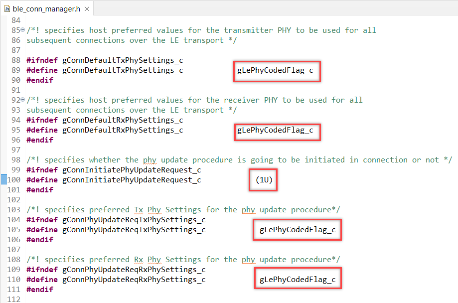

I am using the Wireless UART of KW38 FRDM board.
How can I set up the KW38 to be in BLE Long Range (125kbps) mode?
Please advise.

Hello @ArianRF
Hope you are doing well.
To configure Coded PHY, you can try these changes in ble_conn_manager.h
This should allow you to enable PHY update on connection.
Please, let me know if this is what you are looking for.
Eduardo.

Thanks @EduardoZamora
We will apply this.
