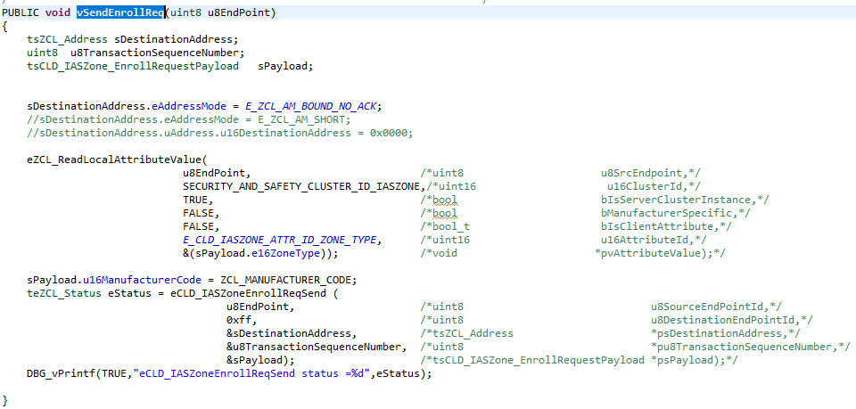

Hi support team !!!
Now I'm working with IASZone Cluster
Base on JN-AN-1201-Zigbee-Intruer-Alarm-System (ZONE). I build a project for my sensor - JN-AN-1217-Router
There are something have modified:
- Add cluster IASZone in SDK Base_device.h
- Add cluster IASZone  in App.zpscfg
Document - Google Drive
then join node to network and send request enroll to ICE (Coordinator)
But No events have occurred in APP_ZCL_cbEndpointCallback (Coordinator)
Log from Router: E_ZCL_ERR_CLUSTER_NOT_FOUND
Can you help me? Thanks
