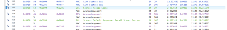

Please look at the file attached. I capture the scene to show the process.

I referred the sniffer log I hope it working for you, which is the case for us using the telegesis dongle.

You could use the Dongle to capture the packets over the air, and work with 2 different modules OM15076
However, I tested by my side. We provide a Scene example for the client and server.
I recommend looking at the JN-AN-1247 Coordinator that provides a GUI Tool and acts as scene client, also the JN-AN-1244 that supports the scene server.
