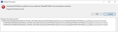

I'm currently trying to upload the SW3683 example codes on the PNEV7462C board with MCUXpresso.  When I tried to Debug a already built simple project (in this example blinky) the debugger can't find the .axf file:
When I checked the location file of the .axf file it is indeed missing:
Am I missing a step ? If not why the .axf file is missing ?

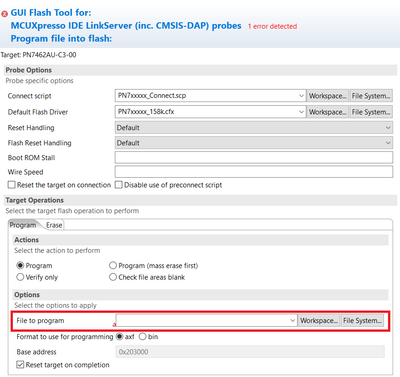

Thank you for the help. I read the thread and did some research but I couldn't find a solution to my problem. I tried to flash the chip but it require the .axf file also:
Unfortunately I still can't find the .axf file for the example project.
Regards.
3,116 Views
Pel
Sorry I just realize that I put the screenshot of the wrong folder here is the right one:
