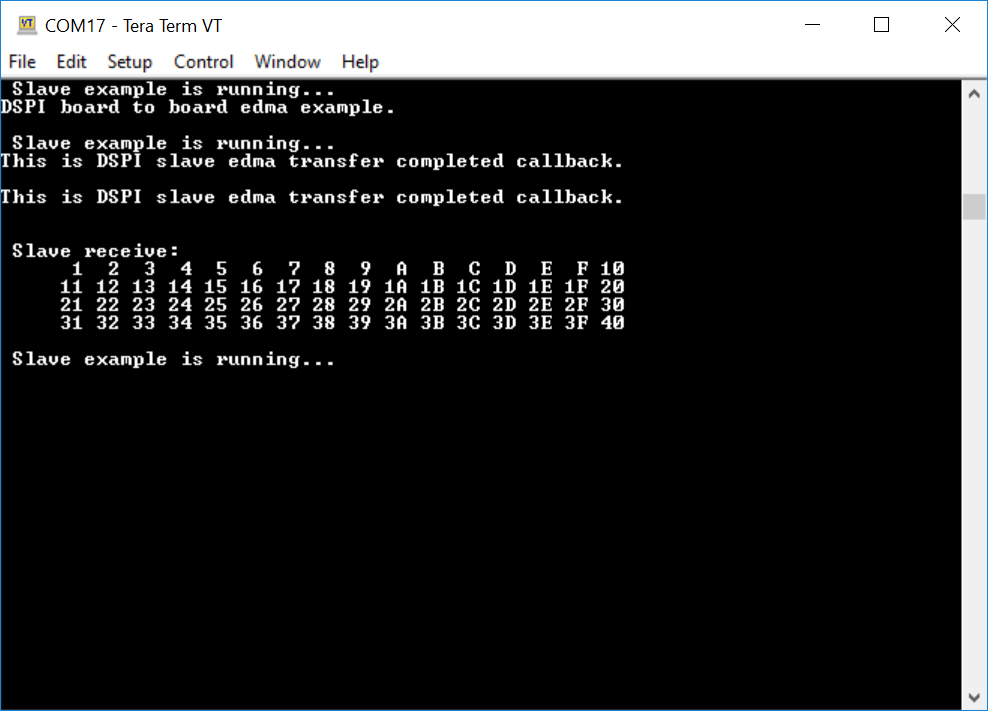

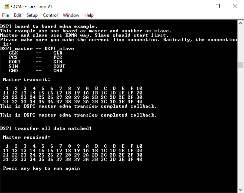

stephanie_m
I tested the slave example and it seems to be working fine.
Slave
Master
Are you sure that you are connecting the devices as it is mentioned in the example? Even though you are not working with the master example of the Rigado board please confirm the connections are well made.
Also, something important regarding the connections how are the J26 and the J27 set in your board? Are those set in the correct functionality?
Another thing you will need to check it's the clock configuration in both devices?
