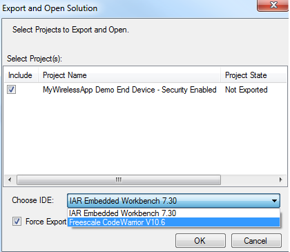

If I would like to import a demo from beekit to codewarrior, how to configure the device with codewarrior? Could you please refer to any documents where I can follow steps to load demo on codewarrior?
Salah
5,715 Views
AngelC
Senior Contributor I
Dear Salah,
Please refer to BeeKit Wireless Connectivity Toolkit User’s Guide – chapter 2.6 Exporting the Solution for further details about exporting and importing the solution.
Link: http://cache.freescale.com/files/rf_if/doc/user_guide/BKWCTKUG.pdf
You could also simply export the solution and select Codewarrior instead of IAR in the Beekit’s prompt message.
