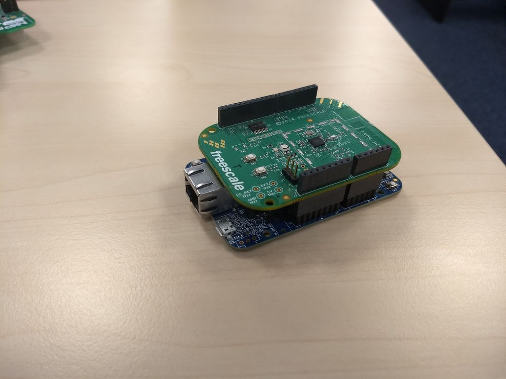

The single role that a KW41Z cannot handle by itself is the border router. The reason is that the chip doesn't know WiFi so it couldn't get out in the Internet. The only protocols known by KW41Z are: ZigBee, Thread and BLE(Bluetooth Low Energy). If you don't mind not having access to the mesh from the Internet, you won't need a border router. As the boards know BLE, you can design for example an android app that controls the mesh network. If you want to have access to the Internet, you need the border router, and the best and cheapest choice is the FRDM K64F + MCR20A sandwich. K64F knows how to communicate via Ethernet and MCR20A knows Thread protocol. Take a look bellow how it looks like this border router.

Unfortunately, MCR20A is just a 2.4 GHz 802.15.4 transceiver. You cannot run applications on it, it only serves as a transceiver, it helps other boards that cannot process 802.15.4 packets. As you saw in the picture I've posted above, MCR20A was mounted on K64F. You can find more about MCR20A here.
