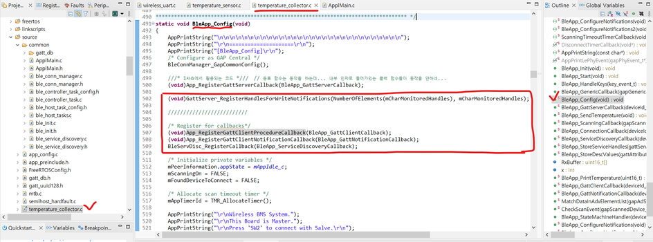

The picture shows "BleApp_Config(void)" in BLE temperature collector.c
As you can see "(void)App_RegisterGattClientProcedureCallback(BleApp_GattClientCallback);" "(void)App_RegisterGattClientNotificationCallback(BleApp_GattNotificationCallback);" It can be confirmed that callback registration functions such as "BleServDisc_RegisterCallback(BleApp_ServiceDiscoveryCallback);" are used, and it has also been confirmed that the callback functions "BleApp_GattClientCallback", "BleApp_GattNotificationCallback", and "BleApp_ServiceDiscoveryCallback", which are entered as internal arguments, are used inside the BLE temperature collector.c code.
Based on this process, I went through the process of registering a callback function to use the callback function of "Server" (temp sensor device).
You can look at line 439 [(void)App_RegisterGattServerCallback(BleApp_GattServerCallback);]. Here, (void)App_RegisterGattServerCallback(); (callback registration function) operates normally (the callback function is registered), but it does not work even if you add the "BleApp_GattServerCallback()" function in the actual BLE temp collector.c.
This is a photo of the BleApp_GattServerCallback() function actually added to the BLE temp collector.c code.
However, the operation of the function cannot be confirmed in Putty... When I see that the output text written within the function is not output, I think the function is not working.
In this case, what is the problem? How do I run the "BleApp_GattServerCallback()" callback function?

Among them, based on BLE temperature sensor.c, as I asked before, you can see that a server callback is installed in BLEApp_Config(void); and utilized within the code.
You can also check that the installed server callback "BleApp_GattServerCallback(deviceId_t deviceId, gattServerEvent_t* pServerEvent)" has [deviceId] and [pServerEvent] as arguments.
Are these arguments automatically entered during Bluetooth connection (pairing) or Bluetooth communication between the temp sensor device and the temp collector device?
In relation to this, if the arguments of the installed server callback function are not entered correctly, may the server callback not run?

The GATT Server Callback is triggered whenever the Client attempts to write the value of an attribute after the corresponding attribute handle has been registered.
More information on this can be found in the BLE Application Developer Guide, Section 5.2.3 Attribute write notifications.

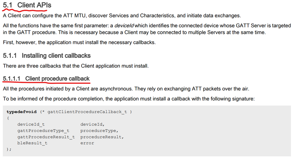

Second question. I'm curious what exactly is the trigger condition for the GattClientCallback function. I checked the guidebook docs, but I still don't quite understand it, so I hope you can answer to make it a little easier to understand.
This is the Client callback function I am curious about. I am curious about the trigger conditions for each callback function: "GattClientProcedureCallback" and "BleApp_GattClientCallback", "GattClientNotificationCallback" and "BleApp_GattNotificationCallback", "BleServDisc_RegisterCallback" and "BleApp_ServiceDiscoveryCallback", and additionally "GattServer_RegisterHandlesForWriteNotifications".

As a final question, regarding GattClientProcedureCallback, if you look at the BLE Developer Guide docs, it is written as if all procedures started by the Client are asynchronous, and the GattClientProcedureCallback is triggered when the procedure completes.
Based on this information, I implemented GattClientProcedureCallback as code on the Server (Sensor device) to implement two-way BLE communication using the Low Power Temperature Sensor and Collector example, but it did not work. I think this is related to my second question. Is it not working because the trigger conditions are not met?
