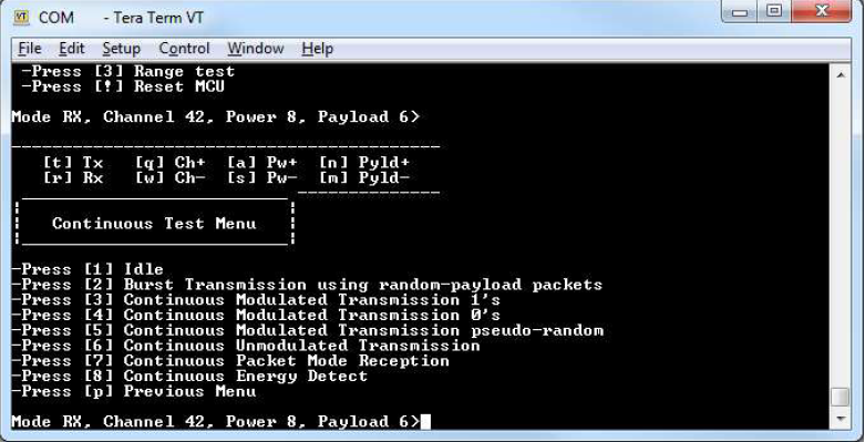

xing_chang
Hi [email protected]‌,
For RF evaluation, please refer to the document AN12076.pdf.
The Generic FSK Connectivity Test allows the user to: set the transceiver in several continuous TX
modes, for details, please refer to the documentation of 'Generic FSK Link Layer Quick Start Guide.pdf' in the SDK.

xing_chang
Hi Kuldeep Chaturvedi‌,
Sebastian is right. It is unrealistic to directly modify the registers to implement your functions. This will be a huge project that cannot be realized.
You can use the GFSK project to try it out. It is also an interactive test environment based on UART, but it provides some APIs. You can bypass the UART interface and directly call these APIs to implement your functions.
Of course, the most convenient way is to make the testing interactively through UART or other interfaces.
project path: ...sdk\boards\frdmkw36\wireless_examples\genfsk\conn_test

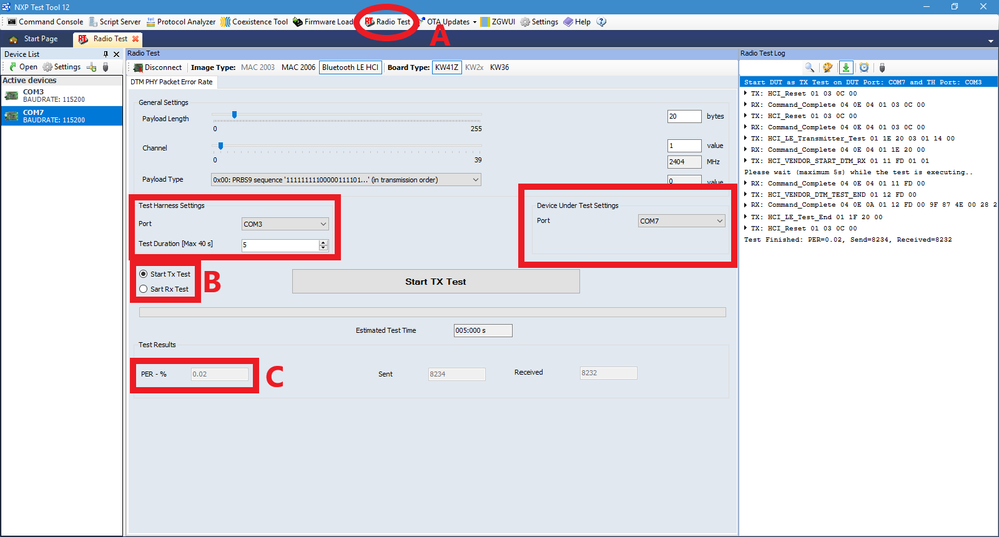

Sebastian_Del_Rio
Hi Kuldeep, I hope you're doing well!
You can do Tx and Rx tests using the NXP test tool's Radio Test mode (Marked "A" in the attached picture).
You'll need to program the HCI Black Box example to both of your MCU's.
You can configure the test to change the payload length, channel and type. In this example, I have used a KW41 (COM3) as a tester and a KW36 (COM7)as the tested device.
You can change between a Tx or Rx text using the selector to the left of the "Start TX Test" button (Marked "B").
The PER test result will be displayed on the PER - % box (Marked "C").
Please let me know if you have any further questions.

kuldeep_chaturv
Hi Sebastian,
We have 2 variant of this product.
Variant 1: KW36 is connected over UART lines with existing Cluster.
Variant 2: KW36 is and independent module in our PWB.
I believe we need the UART connection with external tool in that case do we need to do following:
1. Disconnect the UART lines from meter and connect with external interface with PC.
2. prepare HCI Blackbox demo example and flash the image in KW36.
3. Connect the UART with RF tool .
4. perform the test.
Are the above steps are correct?
Also the above mentioned RX and TX test are same as we are trying to do with those registers manually in code?

Sebastian_Del_Rio
Hi Kuldeep,
The steps you describe are correct, that way you should be able to test the devices. However, you don't necessarily need to disconnect the UART lines from the meter, as you can connect to the tool using the debug UART mapped to the USB port of your device, as well as other pins. You can connect to both maps, and see the commands in the external mapped pins.
This test tool should give you the same results as performing the test via code, it's just done in an easier way as the commands are being sent automatically via the tool to your device instead of being written directly into the code.
