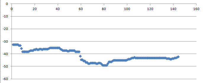

Received Signal Strength Indicator (RSSI) is measurement of the power presented in a received radio signal.
An RSSI use case could be its conversion to distance.
KW0x radio has a RSSI register where RSSI can be read after a reception. To convert the value of the RSSI register to the real RSSI value just apply the next formula:
Rssi_Value = - Rssi_Register / 2.
A range test was implemented in an indoor environment for 8 meters, one measurement each 1 meter to know the behavior of RSSI vs distance.
RSSI varies a lot with different factors like the things in the environment, the weather, etc. The measurements published in this post could be different in each scenario.
Some measurements has been taken for each meter (an excel file it´s attached in the post).
In figure 1 we can see the Raw data measurements.
                                                                   Figure 1: RSSI vs Distance (Raw Data)

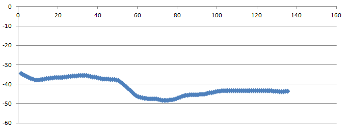

In figure 2, moving average it´s applied to Raw data.
                                                         Figure 2: RSSI vs Distance (Moving average applied)

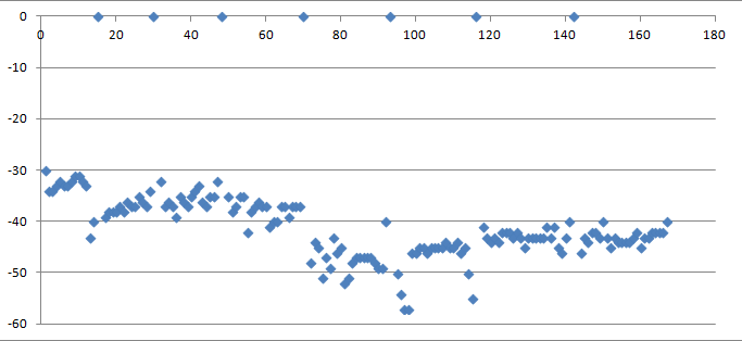

In figure 3 we can see RSSI measurements with median applied.
                                                           Figure 3: RSSI vs Distance (Median applied)

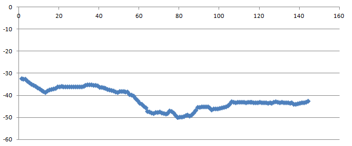

Finally, in figure 4 Moving average it´s applied to the median RSSI.
                             Figure 4: RSSI vs Distance (Moving average of median RSSI applied)
