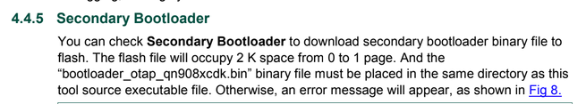

Hi @mario_castaneda,,
Yes, I use SDK Example "bluetooth_otap_client_att" & "framework_bootloader_otap", and Steps by QN908x Programming Tool User Manual 4.4.5
So, I program the otap bootloader and otap_client_att on my board,
After press ADVSW
I can see my device in the list of scanned devices,
but when I try to connect device, I see Status shows that connecting -> connected (only 3secsonds) -> disconnected,
Why is it disconnected ?
Another problem is I selected my .s19 file , but File Infomation No any changes,
Is it because the device is disconnected? Or is my .s19 file something wrong?
.s19 file is also use SDK example "otap_client_att"

mario_castaneda
Hi @Corgi,
What is the process that you followed to program these 2 codes?
but when I try to connect the device, I see Status shows that connecting -> connected (only 3secsonds) -> disconnected,
Did you enable some security features? Just to confirm, are you using the IoT ToolboxApp?
Does this happen when you try to update the firmware?
Mario

Corgi
I just build the project, Go Binaries/ file .axf Binary Utilities / Create Bin and Create S-Record, (MCUXpress IDE)
So I got the bootloader_otap.bin, otap_client.bin, otap_client.s19 and programming by use Qn908x Programming Tool,
Today I use another iPhone I can correctly connect my device, No disconnection.
But I Tapped Open and selected my .s19, File Infomation is still no change,
Can you give me demo .s19 file?
