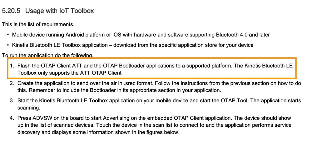

Before Usage IoT Toolbox, I should Flash the OTAP Client ATT and OTAP Bootloader into my board (Qn9080), What should I do?

Hi @Corgi,
Have you programmed a simple example using the IDE that we provide?
Yes, you have to program the bootloader before using the OTAP Client example, you could import the example and flash the code using the MCUxpresso or you could use the Jlink commander to load the bin file.
