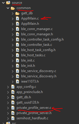

Hello there,
I am using as a base design the private_profile_server_bm to understand how the BLE APIs from NXP work but the code/design is turning a nightmare.
it contains a loads of folders and libraries for the QN9090-DK6 board.
For the point of view of an Application development, the folder "source" seems to encapsulate all required files. However, inside this folder there is a "common" folder which contains some additional files. In particular:
- ApplMain.c : This files seems to include the main loop of the BLE application (main_task()), which it calls then App_Thread(), which in turn calls App_HandleHostMessage(). This last function has a case for BLE message:
- gAppGapGenericMsg_c
- gAppGapAdvertisementMsg_c
- gAppGapScanMsg_c .....
The ONLY messages type that seems to be received are: gAppGapGenericMsg_c.  Then the customer application function gets called: BleApp_GenericCallback(). This is the first function included in what seem to be the Development files ( in this example design, private_profile_server.c)
This is using a bare-metal example design but the amount of calls to reach the first point where a designer can modify the code seems excessive. Plus there are some calls to events queues and other functions/variable which are not accessible from the private_profile_server.c file
main_task() ->  App_Thread() -> App_HandleHostMessage()
-> BleApp_GenericCallback()
- is there any more basic/simplified example design showing a BLE Server stack for the QN9090 device?
- is there some information about how this example design: private_profile_server project works, in terms of APIs and BLE states, call-back functions?
