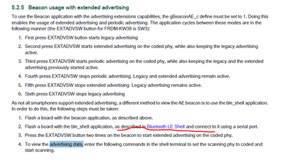

Hello team,
My customer has a plan to read/scan Eddystone-TLM beacons but he doesn't found useful example code for that on the QN9090/30 devices, Could you please point out where there is an example for such implementation of BLE beacons scanner especially TLM.
Waiting for your kind feedback, Thanks in advance
Shai
Labels (2)
2,116 Views
nxf56274
You can refer the beacon example that has the extended advertise. In the doc, you can see some suggestions about how to get the extended advertise.
