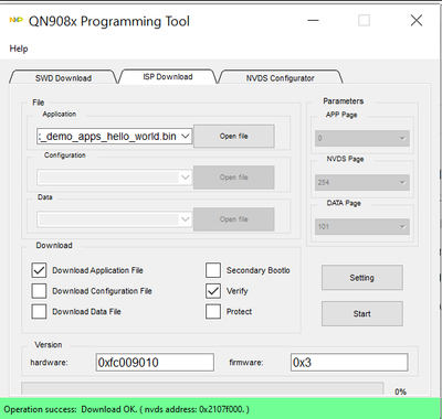

Dassom
Hi @Gavin_Jia,
Thank you so much for the advise!
We were able to flash the hello world demo once. Therefore, it may be running on power up.
Could you please give more specifics on how to make it running in wake-up mode?
When trying to erase flash with GUI Flash tool, we are getting this error.

Dassom
Hi @Gavin_Jia ,
Thank you so much for the advice.
1. When the board is put into ISP mode by jumper setting, MCU-Link pro/J-Link fail to connect to the QN908x chip.
2. QN908x Programming Tool also fails to connect to the ports shown below.
Those bring some questions on our HW setup.
1. For ISP mode, is UART connection required in addition to SWD lines?
2. Are external crystal oscillators (34MHz and 32KHz) required for this operation?
This chip has internal oscillators. QN908x product data sheet 8.23.1.1 says "The internal 32 MHz oscillator can be used as a clock that drives the CPU. Upon power-up, or any chip reset, the QN908x uses the internal oscillator as the clock source. Software switches to one of the available clock sources later"
So we assumed that the internal oscillators can be used in this operation.
9,573 Views
Gavin_Jia
Hi @Dassom ,
1. For ISP mode, UART connection is required in addition to SWD lines.
2. It use internal crystal oscillators 32MHz.
3. For QN908x Programming Tool , I flashed bin file via J2 LPC-Link.
B.R.
Gavin
9,564 Views
Dassom
Hi @Gavin_Jia ,
Thank you so much for the answers.
In ISP mode, my understanding is that bin file will be downloaded through UART to flash memory, which will resolve downloading issue.
However, we would still need SWD working for debugging purposes.
1. Is there any test program to run or any test signal for us to check?  We would like to understand why this error is happening so that we can fix in the next revision if needed.
2. Is there a way to bypass flash erase/write steps and download binary to RAM and run it from there?
9,549 Views
Gavin_Jia
Hi @Dassom ,
I am very glad to hear that it is okay to download code to the board now.
And I think this post maybe useful for this situation. Will it solve your problem if you use other interfaces to put the board into ISP mode?
For the second question, I didn't find there is a way to bypass flash erase/write steps on QN9080. Sorry for any inconvenience.
B.R.
Gavin
