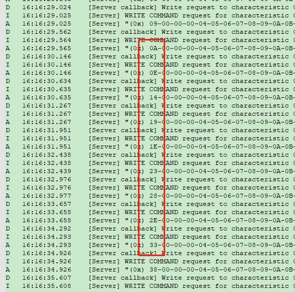

Huawei P10 and mate10 Mobile phones  connect QN9083.
QN9083 Send data at 25ms once,The data is 244 bytes in size.
Then,Huawei P10 and mate10 Mobile phones show High packet loss rate.
but No other phones showed the same phenomenon.
so,We think chip compatibility is a problem.
How to solve this problem?

Do you have a sniffer log to share ? with the traffick of the packets ?

The above is a screenshot of the lost package log part of huawei p10 plus.
The drawing the red box first byte, represents the package number, visible between 0 x10, 0 x11, 0 x12, 0 x13, 0 x15, 0 x16, 0 x17, 0 x18, 0 x1a...It's all gone.

But I need the log to see the communication between the devices so I can try to identify where the problem is, is there a way you can chare a sniffer log?
