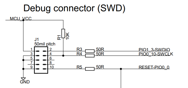

Hello friends,
What pins of QN9080 should I have in a connector in a PCB to program and debug?
I have here a QN9080-DK board and I would like to use it to program others QN9080's. So, I need to know what pins DK board need to program or debug personal boards using QN9080 as SoC.
  • QN
1 返信
1,998件の閲覧回数
Alexis_A
In the next schematic you can see the lines need it to use the SWD interface for a 10 pin connector:
  • SWDIO
  • SWCLK
  • RESET
  • VDD
  • GND
I hope this helps you.
