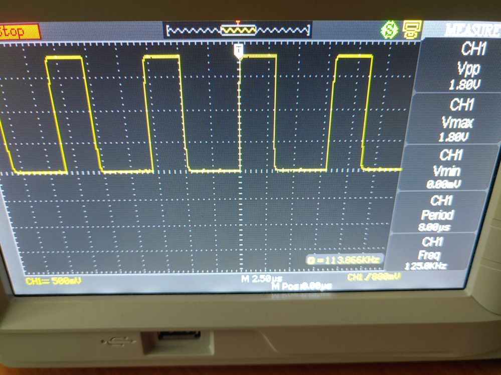

Hello Team,
my customer has the following issue, could you please advise the below:
I am having a problem with using the SCTimer module on QN9080.
The interrupts do not seem to work properly, the interrupts seem to take way too much time.
I am attaching sample code and follows more details.
To use the code add the file to a new project include fsl_sctimer.h and comment out "SCTIMER_EventHandleIRQ","SCT0_IRQHandler" and finally run init on main.
Details:
needed output:
  • PWM output of sine wave in  488Hz with over sampling of 256
What was done:
  • Using a 32MHz clock, the needed PWM frequency is 125kHz (=clock/oversampling)
  • On SCTimer, set the limit counter to 255 (clock/desired frequency -1)
  • Set match event (SCTimer) to a value taken from lookup table at index i.
  • Set actions to clear output limit event and set the output for match event.
  • Then I set an interrupt for limit event
    • On the callback, update lookup index and load a new lookup value to the corresponding MATCHREL register
The problem
  • The resulting PWM output with a low pass (22kOhm and 10nF) was supposed to be 488Hz but was much lower.
  • I assumed the interrupts were handled slowly and so I commented out the driver ISR and rewrote it. In the end I managed to get 13Hz output.

Hi Sebastian,
thank you for replying back, please find Attached the waveforms.
Figure 1 is the direct output of the PWM port and Figure 2 is the output of the  1st order RC low pass filter consists of a resistor of 22Okhm and a capacitor of 10nF.
It can be seen that the output rate is 8uSec (as designed)  and the pulse width is changing. However, after the LPF we get very low frequency which means that the PWM in not responds fast according to the required pulse width.
The output of the PWM is generated from the Sine wave lookup table which is derived through the DDS algorithm.
Please advise back, thanks in advance
BR,
Shai

Hi Shai,
I'm sorry, but could you please clarify what the issue is a bit more?
I see that on the QN9080's side the PWM wave is being generated as it should, and, if I'm understanding correctly, the duty cycle can be changed without issue.
I believe that the problem could either be with the algorithm used, or with the hardware for the Low-Pass Filter.
Sebastian
