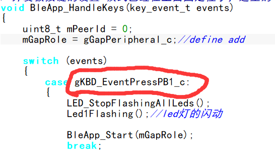

hi
I don't quite understand which of the following functions can set the duration of button pressing.
I want to change the button setting in the red circle to one that takes a long time to press.
For example, after I press for 5 seconds, the following program will be executed
1 返信
1,529件の閲覧回数
nxf56274
你创建了好几个post,我们就在这个post下讨论吧。
关于按键含义gKBD_EventLongPB1_c和gKBD_EventHoldPB1_c,前者就是按的时间长一点,后者是按着不放。按键的检测是在keyboard.c的KeyScan里实现的,里面有判断语句
if(mLongKeyCount >= gKbdLongKeyIterations_c)
keyBase = gKBD_EventLongPB1_c;
if(mLongKeyCount >= gKbdVeryLongKeyIterations_c)
keyBase = gKBD_EventVeryLongPB1_c;
gKbdLongKeyIterations_c这个宏定义是定义的按的时间长短,gKbdLongKeyIterations宏定义为20ms,gKbdVeryLongKeyIterations_c定义为160ms,你要实现长时间按键应该是改这两个值,产生对应的case,然后在BleApp_HandleKeys实现这个情况
