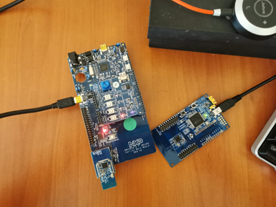

Dear sir,
Please see the hw setup picture.
Thanks.
BR,
Sean

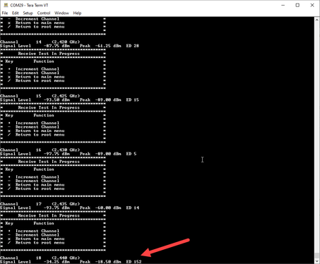

Hi @seanwu,
I ran some tests using the K32W as you did.
I am using the FCC QN9020 example and the CMET K32W Example.
Please look at the next images, The K32W is in received mode, depending on the frequency that the QN9020 is sending the modulated data, the terminal log will show stable data.
You can see that the dBm value is slow, which means that the device is closer. So, the QN9020 is sending some data, if you are not seeing this behaviour, you have to double-check the design that you have.
Mario
