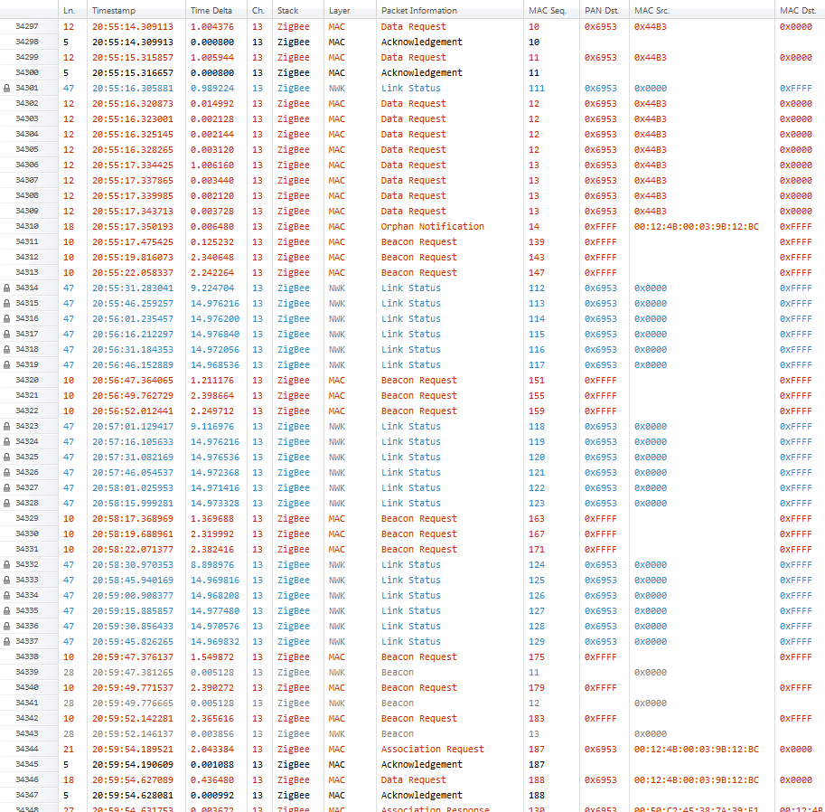

I have run into problems when I upgraded your HA coordinator's firmware to use Codebase 3.1.1. It causes the coordinator to go "deaf" for about 5 minutes in every 4 hour and 45 minutes.
It's very strange problem because it will occur exactly on clock every time. It does either not hear messages sent to it or ignores them completely during blackout. I used sniffer to see that messages are sent but there's no MAC-ACK. Ztc interface "normally" during blackout, and the chip give responses to commands, also it will send messages e.g link status.
This is not an application caused problem because I tested this also "vanilla" build, creating a sample coordinator with HA combined interface -template from Beekit.
This problem does not occur with older 3.0.11 codebase.
-Teemu

I tried with only one thermostat on the network and changed polling time to 1 second. No change, still the coordinator stop listening after 4:45. Here's a sniffer capture log of the situation:
Br,
Teemu

I have tried this with multiple setups. There has been from 2 to 15 devices on the network. The number of devices does not seem affect to the timing of the problem. It occurs always after running for 4 hours 45 minutes.
Device are battery powered thermostat and they are polling (sending Data requests ) the coordinator for every 2 seconds. I haven't try changing the polling time, but I doubt it will have any significance. If it would be related to the quantify of message, I would assume that also number of devices would matter, don't you think?
During this blackout coordinator does not respond any messages, though it will transmit messages if it has any. For example Link status messages and commands sent through ZTC.
