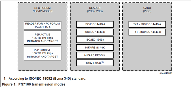

we are currently using the PN7160 in our RFID module.
Is it possible to read calypso cards with the PN7160?
In our case we just have to read the UID
thanks
chris
1 返信
1,631件の閲覧回数
danielchen
Hi @chris123
Calypso is a Type B card.  From PN7160 datasheet, it supports ISO/IEC 14443B card.   so it is possible to read calypso card with PN7160.
