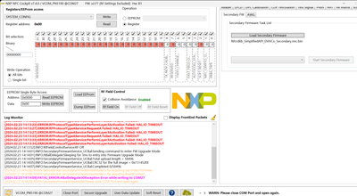

 After using NFC Cockpit (version v7.4.0) to start the PNEV5190BP #PNEV5190BP,  use  the Extra TAB to Load Secondary Firmware, for Refresh the latest version Firmware.  NFC Cockpit automatically directs to the default folder. then start loading the firmware. But some error occured in the process, as shown in the figure. We have try many times but nothing else.
  We want test EMVCo PCD L1 test cases, but failed.

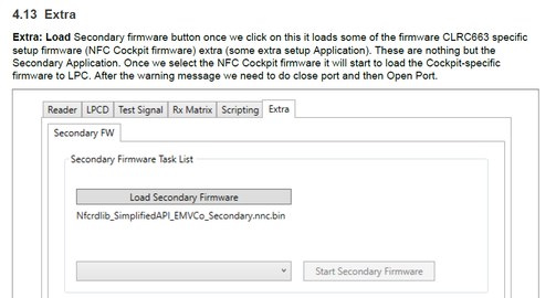

There are some description about loading secondary firmware in UG10025.   section 4.13
https://www.nxp.com/docs/en/user-guide/UG10025.pdf
You also can try this function with the latest version of cockpit, v8.0
