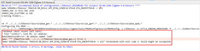

I have re-installed MCUpressoIDE, python3, and sdk of JN8189, and imported the project JN-AN-1246, but failed to compile LTO,It has the following error
The ide version I am using is MCUXpressoIDE 11.9.02144
SDK version:SDK_2_6_12_JN5189
JN-AN-1246:v2008
python is also installed
What is the reason for this error?
Please help solve it.
thank you

Can you please let me know the detailed steps on this case?
Firstly import the SDK then import the project or firstly import the project  then install the SDK?
So that I can have a try to see whether I can reproduce is locally.
And also please unzip the project file before import to have a try.

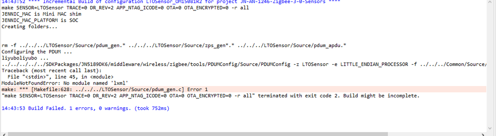

I first installed MCU Xpresso IDE, installed Python, installed sdk, and imported JN1426 project, but the compilation failed and the error message did not show lxml, but this has already been installed.
Is there something wrong with my installation environment?
I installed it according to this procedure

This error may be due to some missing python modules, could you please try installing lxml module for python? You can try using:
pip install lxml
Christine.

Hi, @Tome-mbedded
I tried on my side and after installed lxml, this issue can be resolved.
Please help to try.
And also remind, please check and confirm you have add python into the environment variables PATH.
Christine.

Tome-mbedded
hi @Christine_Li
I reinstalled lxml, but the compilation still failed

Tome-mbedded
thank you,
I have added python to the environment variables, but the compilation returns the same error.
I can't take the next step.
Is there any other reason? Maybe I need to reinstall the entire environment

Hi, @Tome-mbedded
I am so sorry about the inconvenience.
But according to my experience, this error is related to python environment variable path and lxml install.
Also, as you can see my attachment,  I have reproduced this issue on my side, and after re-installed lxml, issue is resolved.
So please double check your python environment variable path and if still failed, then please re-try with a new environment.
I apologize for the inconvenience again.
