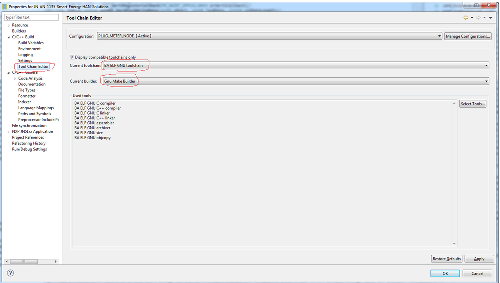

arthurpulatov
I did that in a few steps.

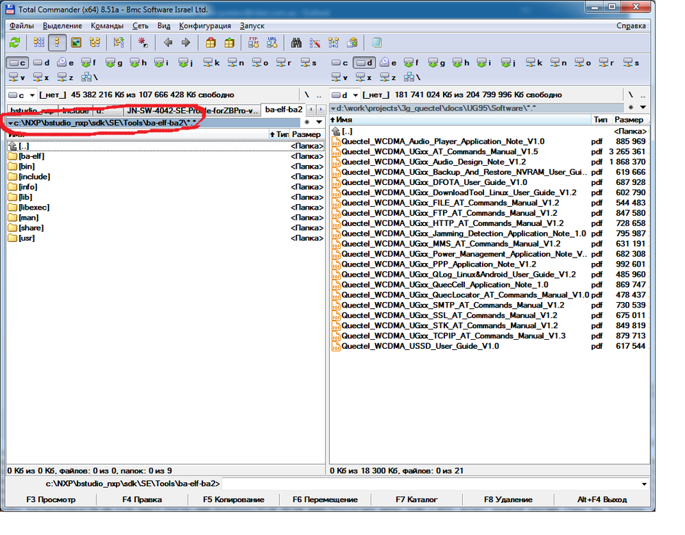

At first you should download and install JN-SW-4041 toolchain somewhere.
After that copy the "ba-elf-ba2" folder from ...\tools\  to SMART ENERGY SDK into ...\sdk\SE\Tools\
Choose BA ELF GNU Toolchain in  Beyond Studio properties

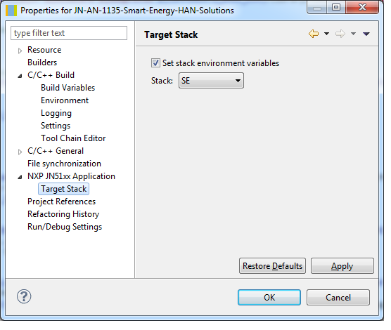

And dont forget to choose the SE as Target Stack

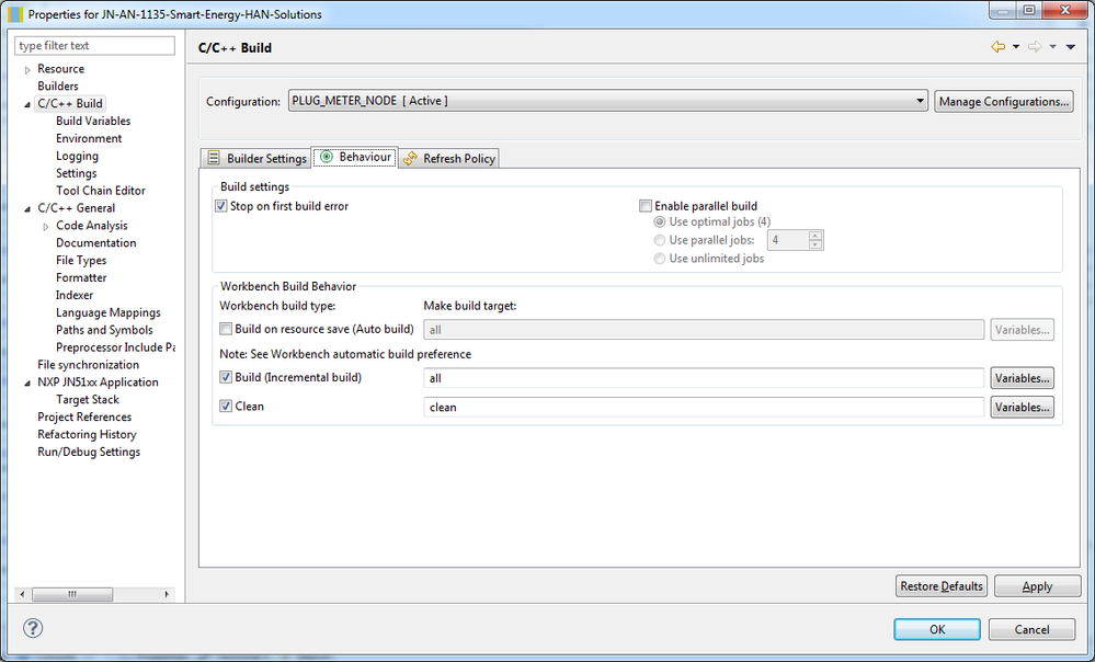

Sure that you still have right "building settings".
(when toolchain was changed they switched into default mode on my PC)

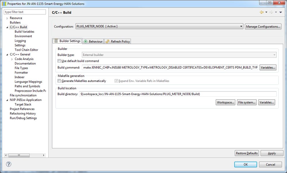

And if everything is right you should do little changes into makefile
i will attach working makefile which sussefully builds on  Beyond Studio
(see JN-AN-1135  PLUG_METER_NODE Makefile in attachment)
