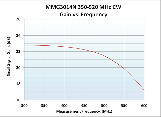

    We intend to use the MMG3014NT1 between 400 and 410MHz. May I ask you to please provide the input and output matching circuits for the same.

Below solution is tuned to 460MHz CW for reference.
Part
Value
Vendor Part #
C1, C4
100 pF
CQM1885C1H101JB01 Murata
C2
10 pF
CQM1885C1H100JB01 Murata
C3
                 1.8 pF
CQM1885C2A1R8CB01 Murata
C5
                7.5 pF
CQM1885C1H7R5DB01 Murata
C6
                0.1 uF
GRM21BR71H104A01L Murata
C7
               2.2 μF
C0805C225J4RAC Kemet
L1
               7.5 nH
0603CS-7N5XJL
Coilcraft
L2
56 nH
0805CS-560XJL
Coilcraft
L3
11 nH
0603CS-11NXJL
Coilcraft
R1
0 Ω
ERJ3GEY0R00V Panasonic
Q1
MMG3014NT1
