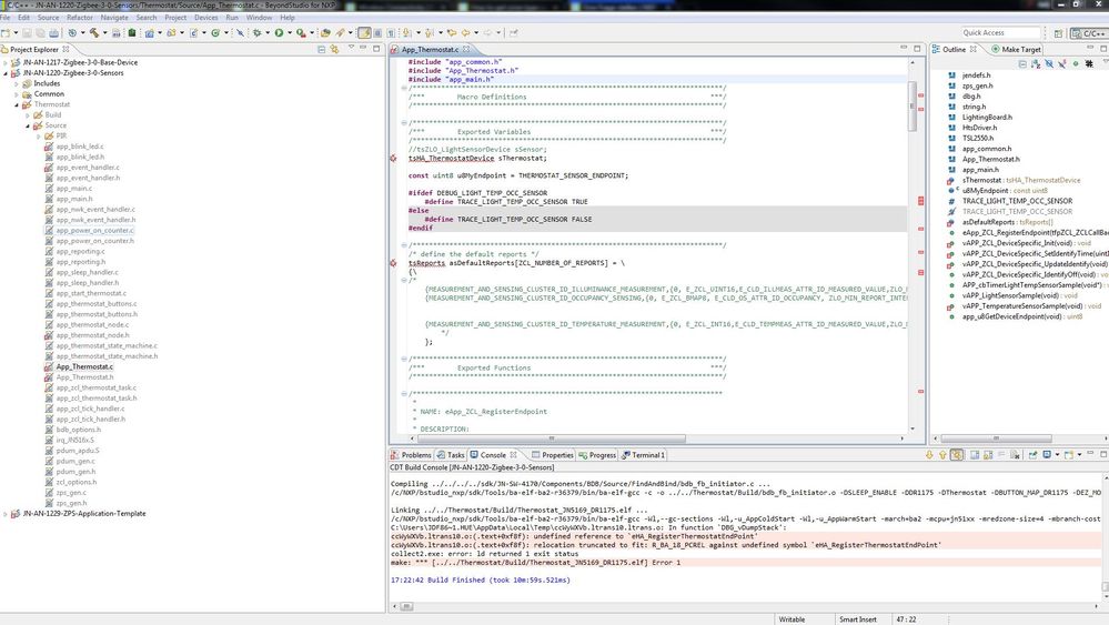

I have started with project JN-AN-1220-Zigbee-3-0-Sensors to build a Thermostat, but I get everytime a linking error and I do not understand why.
I have configured the zcl_options.h
                               #define CLD_THERMOSTAT
                               #define THERMOSTAT_SERVER
And also create
                               extern tsHA_ThermostatDevice sThermostat;
And added
                                #include "thermostat_device.h"
eZCL_Status = eHA_RegisterThermostatEndPoint(THERMOSTAT_SENSOR_ENDPOINT, fptr, &sThermostat);
I can see that the path for the libaries is correct, but anyway added it twice for testing, it has no effect.

I think I found the issue.
If you add all files for the Thermostat Cluster you need also to activate the cluster in your make file:
#APP_CLUSTER_LIGHTING_SRC ?=1
#APP_CLUSTERS_MEASUREMENT_AND_SENSING_SRC ?=1
#APP_CLUSTERS_OTA_SRC ?=1
#APP_CLUSTERS_ENERGY_AT_HOME_SRC ?=1
#APP_CLUSTERS_GREENPOWER_SRC ?=1
APP_CLUSTERS_HVAC_SRC ?=1
#APP_CLUSTERS_SMART_ENERGY_SRC ?=1
#APP_CLUSTERS_IAS_SRC ?=1
Try it out.
