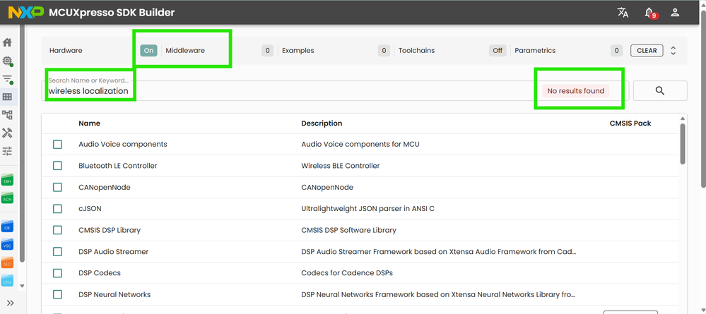

Hello NXP,
I am currently working on the KW45B41Z-LOC for a channel sounding application. According to the available on the NXP website, a wireless ranging example is provided (Section 4.1: Downloading SDK with Wireless Ranging Application). The manual mentions that this example should be downloaded from the middleware section under Wireless Localization.
However, I am unable to locate this option in the SDK Builder page.
Could you please assist me in downloading the SDK that includes the wireless ranging application?
Thank you for your support.

Wireless Localization is under controlled, and be accessible to selected users only.
As I know, firstly you need to sign NDA with NXP, then apply for secure files access to move forward.
And also I checked on my side, for KW45B41Z-LOC, the latest SDK(v25.12.00) doesn't include Wireless Localization. If you already signed NDA and also already requested secure files access to get Wireless Localization, then you can check v25.06.00 SDK. On my side, v25.06.00 SDK includes Wireless Localization Middleware.
If you already signed NDA, would you please send to me your NDA number, so that I can check whether it is still valid.
Here, the community is public. To protect your personal/company's information, please send your NDA number to my private working email: [email protected].
Please not post it here in public community.
If you haven't sign NDA, you can refer to below link to move forward, but for your info, it will need some time.
And I could not guarantee that you can get this secure files access because our Product Management team will assess your project annual volume.
The last but not the least, for KW45, currently we do not recommend to use Channel sounding feature, and also not update new SDK to support CS feature.
If you insist to use Channel sounding feature, we strongly recommend to choose KW47, but not KW45.

Yes, KW47 supports Channel sounding feature, and also this feature should already be included in our SDK v25.12.
You can download this SDK through below link:, input KW47, choose one of the board, EVK or LOC, then click Others. It will show like below:
https://mcuxpresso.nxp.com/select
And currently the "Wireless Localization" middleware is also under controlled, is only accessible for selected users. I am checking with our product management team about the process how to get approved for this.
