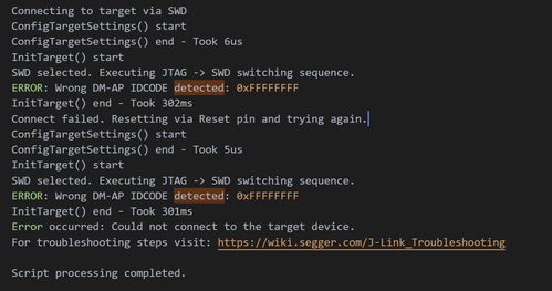

Hello NXP Team,
I am developing a mass production flow for the KW45B41Z83A, following AN14003. While my SB3 generation and flashing process is working, I am facing a critical issue with the Debug Authentication flow that I believe is caused by an incomplete fuse provisioning sequence.
Environment:
  • MCU: KW45B41Z83A on KW45B41Z-EVK board
  • Probe: On-board MCU-Link flashed with J-Link firmware
  • SPSDK Version: 3.1.0
  • J-Link Version: V8.12a
Problem Description: The target board for this test is in the OEM SECURE WORLD CLOSED state. When I run the nxpdebugmbox -i jlink dat auth command, the cryptographic handshake appears to succeed (the DAC/DAR exchange is logged correctly, and RoT Hashes match), but the command ultimately fails with Access to AHB is not granted. A subsequent connection attempt with J-Link Commander fails with ERROR: Wrong DM-AP IDCODE detected: 0xFFFFFFFF.
Critical Information about the Target Board's Provisioning: The board was moved to the OEM SECURE WORLD CLOSED state using an incomplete procedure. My colleague executed only the first command from a sequence recommended in another Application Note (AN14158):
  1. blhost -p COMX fuse-program 0xa 0xf was executed to advance the lifecycle.
  2. Crucially, the board was manually reset immediately after this command.
  3. The subsequent fuse-program commands from the sequence to program TZM_EN (fuse 0xd), SB3KDK (fuse 0x20), and RoTKTH (fuse 0x1f) were skipped.
As a result, the board is in a SECURE lifecycle state but is likely missing other critical fuse configurations required by the ROM for proper operation in this state.
My Core Question: Could this incomplete provisioning procedure (advancing the lifecycle to OEM SECURE WORLD CLOSED without programming the TZM_EN fuse, etc.) be the root cause of the Access to AHB is not granted error? Does the ROM bootloader's debug authentication mechanism depend on these other fuses being correctly set, even if the cryptographic portion of the authentication succeeds?
This seems to be the most likely cause, as all my keys, certificates, and cc_socu configurations have been verified to be correct.
I am preparing to provision another OEM OPEN board using the complete, correct procedure, but I would appreciate your expert confirmation on this matter. I will attach my configuration files and the key log files for your reference.
Thank you for your guidance.
Attached are debug log info:

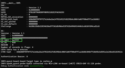

Hi @JabezLaw
When you set it CC_SOCU to 0x0000 you are disallowing the "certificate holder" from acquiring any access rights that are allowed in the device.
This is so that you can for example allow all ports to be open, but you want technician A to only debug a certain port and technician B to only debug a different port so you can further allow or disallow their access rights. Setting 1 on a specific bit field, means that it will follow the device's security level for that field and setting a 0 on a specific bit field will disallow access despite the device's security level.
The main difference I see in your workspace compared to mine is the lifecycle stage. Are you testing a second development stage? The secure world closed is not a recommended final production lifecycle, however this not prevent a successful debug authentication session. Though it is the main difference I notice.
Here is my result on my end:

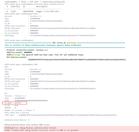

Hi @Sabina_Bruce ,
Thank you for your suggestion. I appreciate you taking the time to look into this.
I have followed your advice precisely. I modified my dc_config.yaml to set cc_socu: '0xFFFF', regenerated the debug credential, performed a full Power-on Reset (POR) on the OEM SECURE WORLD CLOSED board, and then re-ran the authentication command.
Unfortunately, the result is identical to my previous attempts. The cryptographic handshake appears to succeed, but the process fails at the final step with the exact same error: Access to AHB is not granted.
This outcome aligns with my understanding of the KW45 security model as described in Table 91 of the Security Reference Manual (KW45SRM). My interpretation is:
  • The device's fuses (DCFG_CC_SOCU_L1 = 0x00000000) configure the debug domains to Level 1 (disabled by default, but can be enabled via authentication).
  • Setting cc_socu to 0xFFFF in the debug credential creates a request for Level 0 access (always enabled).
This seems to create a logical conflict between the requested permission and the device's actual fused state, which would correctly result in a failure.
Since both a logically correct request (cc_socu: '0x0000') and a max-privilege request (cc_socu: '0xFFFF') lead to the same Access to AHB is not granted error, it strongly suggests the issue is not with the cc_socu value itself.
The core problem seems to be that the ROM is deciding not to grant AHB access even after the cryptographic portion of the authentication is successful.
Could there be another fuse setting or a prerequisite that we are missing, which acts as a master gate for granting AHB access in a secure lifecycle state?
I have attached the log file from the latest test using cc_socu: '0xFFFF' for your analysis. Any further insights you can provide would be greatly appreciated.

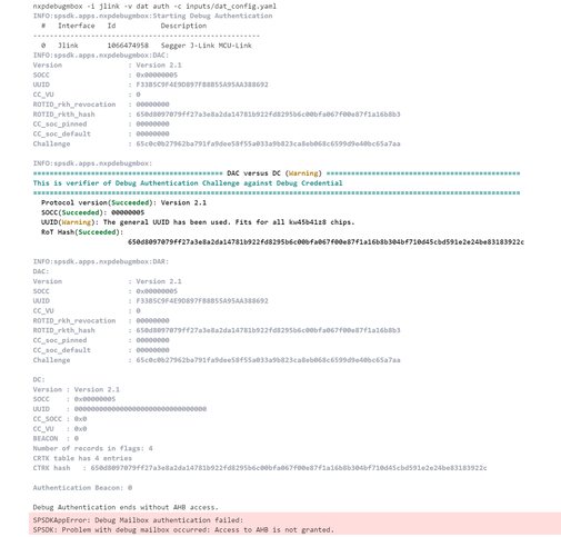

Hi @nxa17177,
Thank you for the follow-up and for pointing me to AN14158.
Yes, I have carefully reviewed AN14158 ("Debug Authentication on KW45/K32W148") again, and I can confirm that my workflow is fully consistent with the procedures outlined in section 5.5 ("Debug credentials and authentication").
To be precise, here is a summary of my validated process:
  • Keys & Fuses are Correct: My RoT keys and SB3KDK are correct. This is proven by (1) my ability to successfully flash SB3 files (which depends on both keys) and (2) the matching RoTKTH reported by the device itself in the DAC response.
  • Configurations are Correct: My dc_config.yaml correctly uses cc_socu: '0x0000', and the dat_config.yaml points to the correct certificate and secp384r1 private key.
  • Toolchain is Correct: I am using the latest SPSDK (v3.1.0) with the -i jlink backend and the probe is flashed with J-Link firmware, as recommended.
Despite this correct setup, the process consistently fails at the final step. The log below clearly shows a successful cryptographic handshake, immediately followed by the failure.
Execution Log (nxpdebugmbox -i jlink -v dat auth ...):
INFO:spsdk.apps.nxpdebugmbox:Starting Debug Authentication
INFO:spsdk.apps.nxpdebugmbox:DAC:
Version                : Version 2.1
SOCC                   : 0x00000005
UUID                   : F33B5C9F4E9D897FB8B55A95AA388692
ROTID_rkth_hash        : 650d8097079ff27a3e8a2da14781b922fd8295b6c00bfa067f00e87f1a16b8b3
INFO:spsdk.apps.nxpdebugmbox:============================================== DAC versus DC (Warning) ===============================================
  RoT Hash(Succeeded): 650d8097079ff27a3e8a2da14781b922fd8295b6c00bfa067f00e87f1a16b8b304bf710d45cbd591e2e24be83183922c
INFO:spsdk.apps.nxpdebugmbox:DAR:
Debug Authentication ends without AHB access.
SPSDKAppError: Debug Mailbox authentication failed: SPSDK: Problem with debug mailbox occurred: Access to AHB is not granted.
Since the cryptographic part of the authentication appears to succeed, the failure seems to be in the tool's final step of actually gaining bus access. My core question therefore remains:
What specific conditions within the KW45 ROM or the J-Link driver interaction would cause an Access to AHB is not granted failure after a successful cryptographic handshake?
This issue is the final blocker for our secure development workflow, and any specific insights you can provide on this specific AHB access problem would be extremely helpful.
