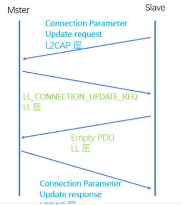

Hello! Our KW45 Bluetooth side is the slave, and TI's CC2642 chip is the host. When the host is connected to KW45, it will hibernate after 60 seconds without any operation and turn off all RF signals of the host CC2642. However, the protocol stack on the KW45 side prompts disconnect until about 20 seconds after the host goes into sleep. It is not clear whether KW45 is in a virtual connection state during this time, and is there any way to improve this situation?
As shown in the figure below, it should actually prompt the detection of Bluetooth disconnection near 14:28:00:00, but the actual delay is 20s.
In the code to try to modify the air packet timeout parameter, the default is 10s, try to change to 3 seconds, but the phenomenon has not been improved, please tell me how to set the Bluetooth parameters?

Hello ,This parameter updates whether it is used by the slave or the host.
BleConnManager_GapCentralEvent()
BleConnManager_GapPeripheralEvent()
How do I need to modify and use to meet the general Bluetooth protocol for parameter update requirements?

hello!
When we were connecting to Bluetooth, the Bluetooth slave did not send connection parameter updates to the host. We have repeatedly found that this situation occurs because the Bluetooth slave connection parameters have not been updated. How does the process of connecting parameters work in the protocol stack? Where can we modify it so that it can update the Bluetooth connection parameters of the slave machine.

HI!
     We found that the updating process of Bluetooth connection parameters was not successful. If this problem can be solved after the successful updating of Bluetooth connection parameters, we have experimented with chips from other manufacturers. However, the KW45 Bluetooth connection parameter update process seems to be unsuccessful. May I ask how to set this up? I'm making a Bluetooth slave here.

Taiyi
Taiyi_0-1703033174948.pngTaiyi_0-1703033174948.pngWe use this version of the SDK SDK_2_12_4_KW45B41Z83xxxA, the circuit board is our company's reference to the design of the development board developed by themselves.
