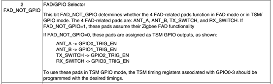

My customer is trying to use the KW40Z  in their ZigBee products.
And they need to add external power amplifier and LNA to extend the RF Range for the product. However, they have encountered a problem on this part.
They use single antenna configuration and use only one GPIO PTC2 to control the TX/RX switch of the FEM (Front End Module).
Refer to the chapter 31 (FEM) and chapter 51 (ZLL) of the reference manual (Document Number: MKW40Z160RM Rev. 1.2, 10/2015):
Register/Field Name
Setting1 (Use TSM)
Setting 2 (Use FAD)
PTC2
Output GPIO (MUX=1)
MUX = 4
ZLL_FAD_CTRL Register:
FAD_EN
0
1
ANTX
0
0
FAD_NOT_GPIO
0
1
ANTX_EN
01
01
ANTX_HZ
0
0
ANTX_CTRLMODE
0
0
ANTX_POL
0
0
TSM Registers:
TSM_TIMING42
Have tried the following values with the above FAD Control Register value:
0x00000000
0xFFFFFFFF
0x01010101
0x03030303
0xFFFF0000
0xFFFF0303
0xFFFFFFFF
Base on the above settings, the PTC2 always stays low even when the KW40Z transmitting and receiving data.
Also the gpio pin mapping shown in page 1036 and page 1408 of the reference manual are not consistent.
Can anyone advise the correct setting to enable the TX/RX Switch pin (PTC2) for 802.15.4.
Thank you very much!

Thanks for the information. Customer have try the FAD setting accordingly and change the GPIO MUX to ALT2. However, we still cannot see the TX_SWITCH pin and RX_SWITCH pin switching according to the TX/RX operation in application.
Do we have any tested example code can show that FAD operation?

For the FAD TX SWITCH issue, please add below extra function call.
XcvrFadLppsControl(FAD_ENABLED);

To use TX_SWITCH and RX_SWITCH, ANTX_EN (ZLL_FAD_CTRL) needs to be configured as: 01 only RX/TX_SWITCH enabled, also mentioned on chapter 31.1.4.3.
From the comment of keli​, I can see that PTC2 (TX_SWITCH) is being configured as GPIO.

This is the reason because it stays low. To use TX_SWITCH and RX_SWITCH output, the pin mux of PTC2 and PTC3 must be configured as alternative 2 (please refer to KW40 Reference Manual, Chapter 2).
Alberto

Hi keli​, TX_SWITCH (PTC2) and RX_SWITCH (PTC3) are mainly used by Fast Antenna Diversity feature. If I understand, your client is trying to extend their range using a PA with a single antenna configuration. In this case, it is not necessary to configure these pins neither FAD. They can control the PA to switch between TX and RX using a GPIO.
Alberto
