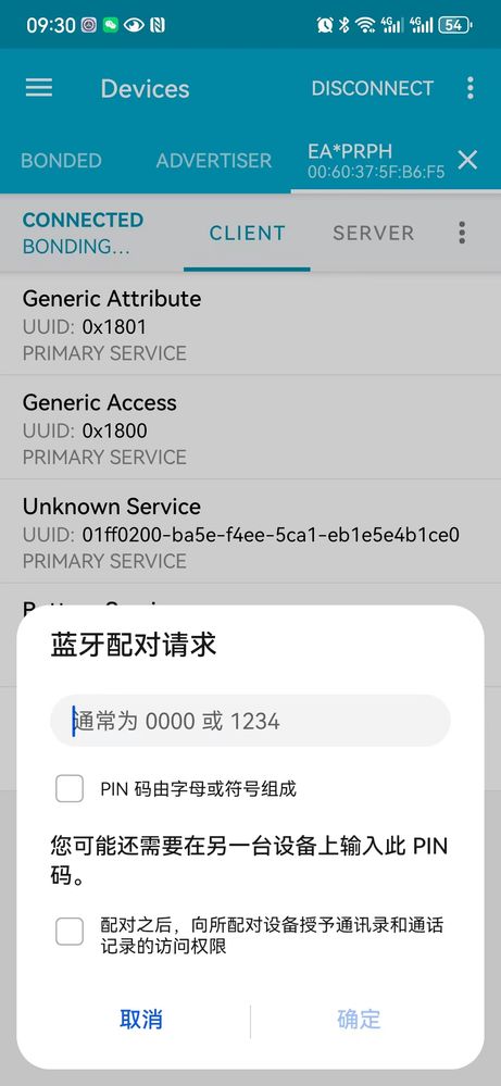

I have a KW38 Demo board. And Download test application frdmkw38_adv_ext_peripheral_freertos from SDK.
Connect the KW38 board by nrf Connect APP. It can found the device KW38.
When I Pair with it. Try PIN 0000 or 1234, It all fail.
The correct PIN for pair is ???

Hello JackYu2,
You can find the passkey of the examples in app_preinclude.h, the define gPasskeyValue_c:
I.e. the default passkey is 999999.
