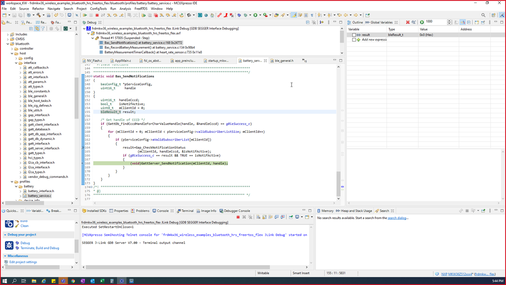

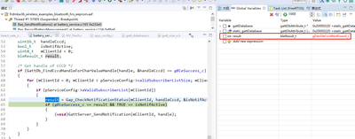

When I enable battert level notification, Gap_CheckNotificationStatus returns gDevDbCccdNotFound_c, so it can not send notifications.

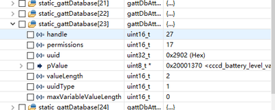

handleCccd is 27, I can found it in static_gattDatabase:
if I set  gAppUseNvm_d  to 0, Gap_CheckNotificationStatus returns 0.

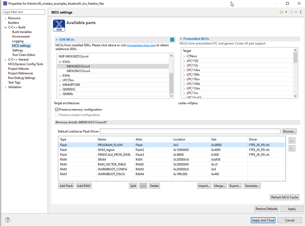

Hope you are doing well. First of all, I would recommend to check your memory Locations and Sizes. For this you can refer to section 4.6.1.1 of the Reference Manual (pages 135-138).
We have made the following test:
First, using the flexnvm example, with gEEPROM_DATA_SET_SIZE_CODE_c (0x33U) and gFLEXNVM_PARTITION_CODE_c (0x3U).
And then, running the HRS example, with the following memory configuration:
And we were able to get the Notification Status correctly:

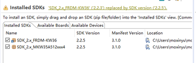

So you need to check your memory settings and also I would recommend to use the newest SDK version.
