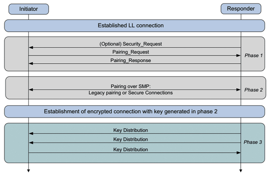

I have one more doubt.
If i use 6sec to update connection parameters, should i use pairing and bonding after these 6 sec?
Or can i use the first 6 sec to handle pairing and bonding?
Which is preferred?
Nidhin
5,011 Views
EduardoZamora
It would be safe if you start pairing and bonding process after updating Connection Parameters.
Eduardo.
