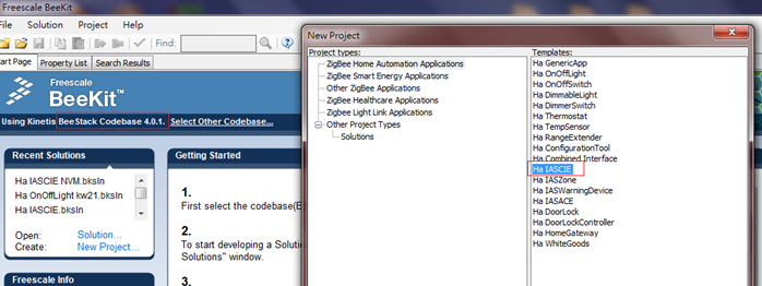

I created a new example project about ZigBee using BeeKit.
Example is: Ha IASCIE.

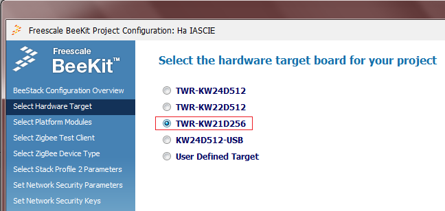

Codebase is BeeStack Codebase 4.0.1.
Target board is TWR-KW21D256.

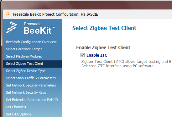

Enable ZTC.

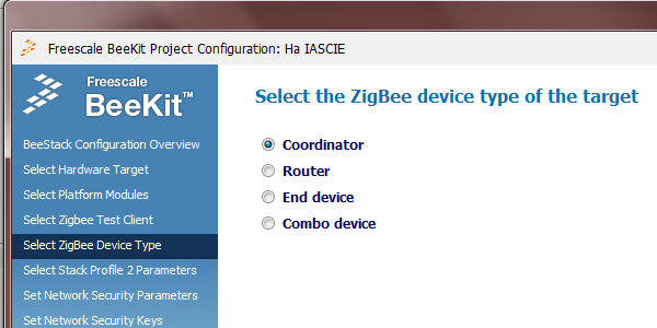

The device type is Coordinator.
Other settings are default, and export the project to IAR.

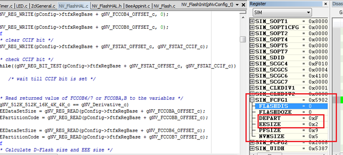

I also traced the code more, and found the error point is:
  /* Initialize flash HAL driver */
NV_FlashInit(&mNvConfig);
#if (gNvUseFlexNVM_d == TRUE) && (gNV_DEBLOCK_SIZE_c != 0)  /* FlexNVM */
  /* check data flash IFR map */
  if(mNvConfig.EEEBlockSize == 0)
    return gNVM_NvWrongFlashDataIFRMap_c;

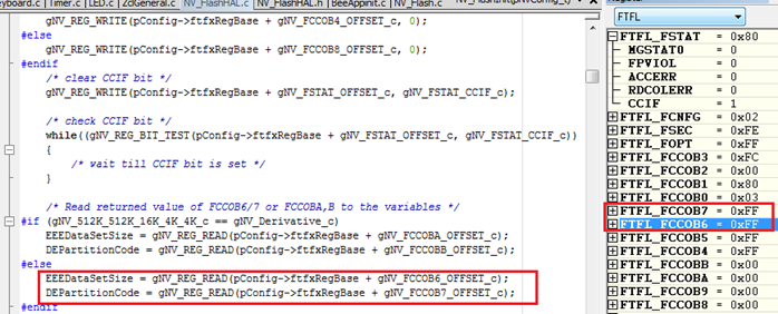

EEEDataSetSize and DEPartitionCode are 0.
FTFL_FCCOB6 and FTFL_FCCOB7 are 0xFF.
But I see SIM_FCFG1 register. EESIZE is 0x2 means 4k.
I am confused about the two differences, and why the FlexNVM module initialize failed?

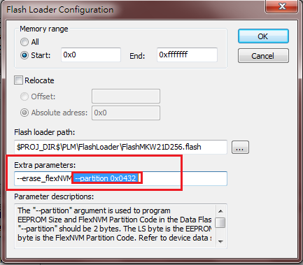

Dear Sir,
Thanks for your support, Your method is OK.
And I have resolved the issue before.

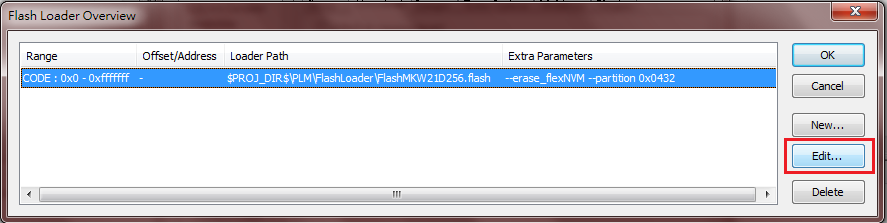

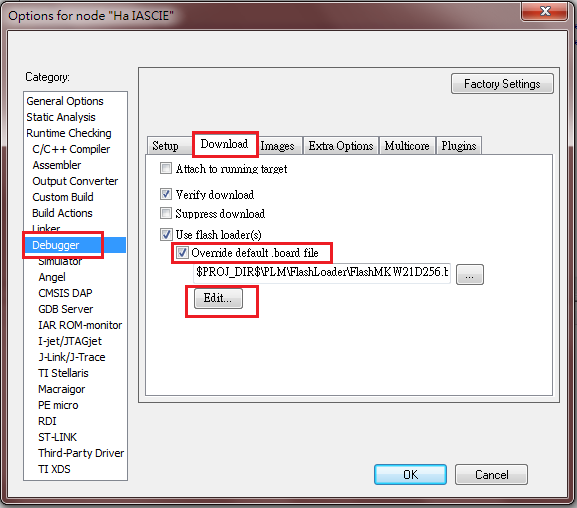

My method is add parameter in IAR like below:
In the project options, go to the Download Tab in the Debugger category.  Check the box "Override default .board file"  Then click the Edit button
Select the memory range for the program flash, starting at address 0x0.  Click the Edit button.
In the Extra Parameters field, add --partition 0x0432 after –erase_flexNVM.  Click OK.
04: FlexNVM Partition Code(DEPART).
32: EEPROM Data Set Size(3: EEESPLIT, 2: EEESIZE).
More description about “--partition”:
The "--partition" argument is used to program EEPROM Size and FlexNVM Partition Code in the Data Flash IFR.
The value after"--partition" should be 2 bytes. The LS byte is the EEPROM Size and the MS byte is the FlexNVM Partition Code.
Refer to device data sheet for EEPROM Size and Partition Code settings.
Note1: Using "--partition" arg will erase all program flash memory, data flash memory, data flash IFR space, EEPROM backup memory, and FlexRAM.
