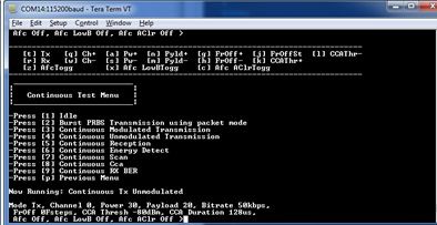

          A) Continuous Tx Unmodulated: the transceiver broadcasts an unmodulated signal on the channel selected from the shortcut keys. This feature is great if you want calibrate channel central frequency. Simply connect the transceiver to a spectrum analyzer and select this option from                the menu. Then, with the use of ‘g’ and ‘h’ shortcuts, move the frequency to a desired value. When this value is achieved, press ‘j’ to store that value to flash. After reset, the trimming parameter will be loaded automatically, ensuring maximum performance. If you choose to load a                different application, you can also benefit from the calibration parameter.

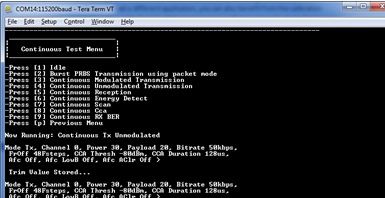

     How to:

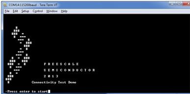

         Calibrate your board using Continuous Tx Unmodulated and calibration features

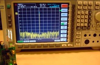

          I. Start the test                                                                                                                             II. Observe channel 0 frequency is not at 920.6 Mhz (Japan, 50kbps)

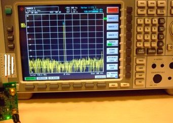

          III. Increase FrOff using 'g' shortcut key and observe how that affects the central frequency

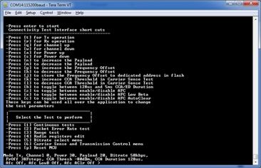

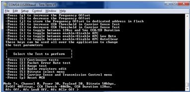

          IV. Store to flash, reset the board and observe that value is kept after reset.
