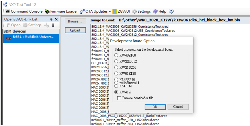

I use "Test Tool 12.9.1.0" to test Multillink.
The following screen will be presented without k32w selection items
and the word of option may be overwritten on WIN10.
How do I choose to make K32W work properly?
Can I choose KW41z to download K32W image?
Or the function of K32W has not been released?

Hi Estephania,
You may have misunderstood the question I want to ask.
I knew very early that it can be updated using FTDI port and JN518xProgrammer.exe.
The following screen will be presented without k32w selection items  on WIN10.
What I want to know is whether Firmware Loader of Test Tool via Multilink  and SWD slot can be used  on K32W ?

stephanie_m
Currently the support is limited to the description in the application note.
If there is any change or update, we'll post it here.
Sorry for the inconveniences this might cause you.
Regards ,
Estephania

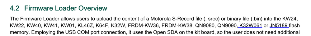

stephanie_m
In the same document you are using as a reference you can find the chapter 4.2.1.4 Flash Programming of the QN9090, K32W061 or JN5189 Using FTDI port and JN518xProgrammer.exe .
It shows how the Test Tool supports through the Flash programmer the K32W.
