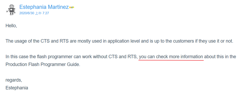

I’ve got the file before, but where can’t I find it about CTS/RTS is not needed?
4,430 Views
stephanie_m
Hello !
Could you please help me with the reference on where you are seeing that for the ISP programming you need CTS and RTS ?
If you check the User Manual of the device you can find in the chapter 38.4 Physical Interface
The ISP protocol is implemented on USART 0, using DIO9 for RX and DIO8 for TX. The baud rate is 115200 with formatting of 8 bits per character, no parity bit and 1 stop bit.

stephanie_m
The usage of the CTS and RTS are mostly used in application level and is up to the customers if they use it or not.
In this case the flash programmer can work without CTS and RTS, you can check more information about this in the Production Flash Programmer Guide.
