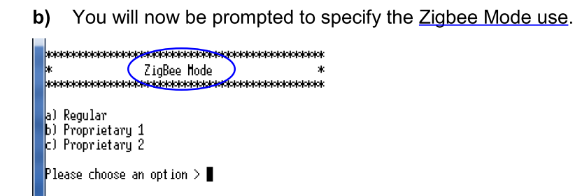

I study JN-AN-1242
The test item of CMET only lists Zigbee mode, so it is only suitable for testing Zigbee, not suitable for testing BLE and Thread ?
We need CMET for BLE and thread. When can CMET add these two options?

4,944 Views
Sebastian_Del_Rio
Hi Daniel, I hope you're doing well!
The JN-AN-1242 Application Note for the K32W is designed as a test mode for IEEE 802.15.4-based communications protocols, like ZigBee.
The CMET is not designed for use with the Bluetooth Stack, instead, there are some SDK Examples included which can help perform tests with this protocol, like the HCI Blackbox in combination with the NXP Test Tool, available to download from this page.
