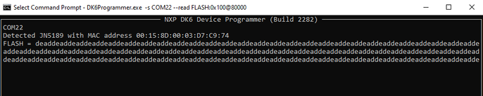

mario_castaneda
Hi Viki,
In this case, when the DK6Programmer erases the FLASH memory, it writes 0xDEAD.
You can erase or read out the memory with the following commands.
DK6Programmer.exe -s COM22 --read FLASH:0x400@0
DK6Programmer.exe -s COM22 --erase FLASH:0x100@80000
DK6Programmer.exe -s COM22 --write FLASH:0x04@80000=0x1234
Mario

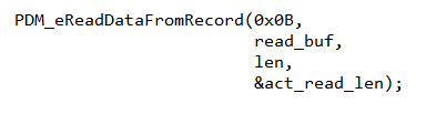

Viki
Hi @mario_castaneda ,
I'm sorry for replying to you so late.
After many tests, I downloaded the program using the command "DK6Programmer.exe -s COM17 -e FLASH -p jn5189dk6_zigbee_coordinator_bm.bin ", the value of reading user storage area is 0x00, and the function used for reading user data storage area is:
Do I set the value of the user's storage area to 0x00 every time I download the program using the "DK6Programmer.exe -s COM17 -e FLASH -p jn5189dk6_zigbee_coordinator_bm.bin "instruction? Is this normal?
BR,
Viki
4,025 Views
mario_castaneda
If you want to save some data in that direction you could specify the offset that you want.
You could try to read the data as in the example.
PDM_eReadDataFromRecord(PDM_ID_APP_END_DEVICE,
&sDeviceDesc,
sizeof(tsDeviceDesc),
&u16ByteRead);
Mario
