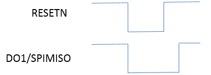

 Can you tell me how JN5179 is going into programming mode? I follow the instructions of the technician SPIMIMO-> GND,RESET-GND,VDD->3.3V still can not recognize the JN5179 device. Thank you.
4,424 Views
MattGillespie
All of the JN devices require DO1/SPIMISO to be low when RESETN is released. See the image below. Reset must be released so that the CPU can start running. It will then start running an application in the bootloader that lets you program the internal flash memory over the UART.

wupengfei
  I make it success.  thanks for your help.
