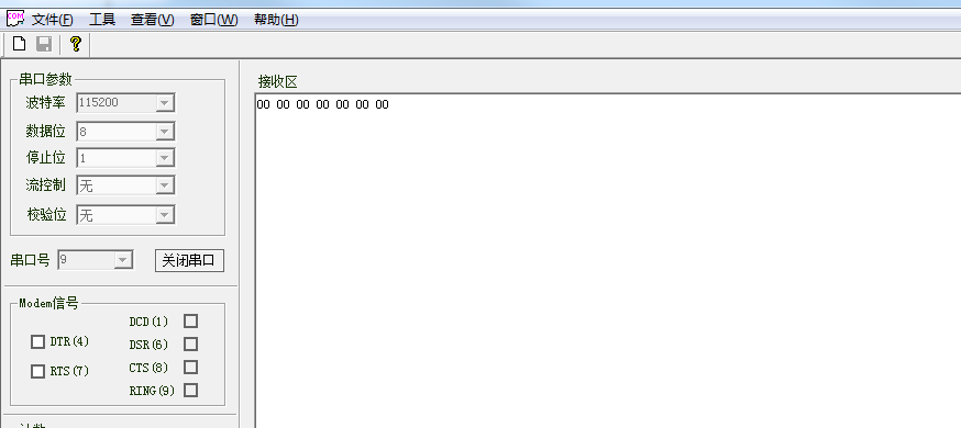

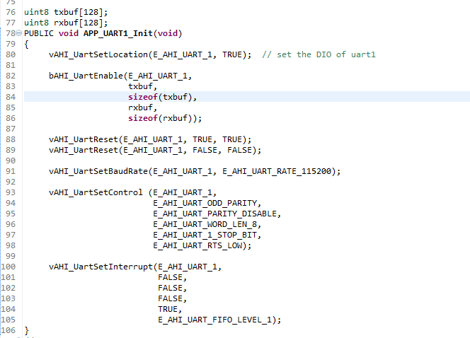

   My problem is below:
   I send  the uart data to the computer through uart1,but it is failure;
   (uart0 can work normal,it can printf log)
   uart1 initialize:
I use APP_UART1_WriteByte(0x11); send data, and the computer receive nothing;

Hi Dylan,
You can work with the uart.c and .h files, included in the next path.
C:\NXP\bstudio_nxp\workspace\JN-AN-1217-Zigbee-3-0-Base-Device\Coordinator\Source
In the makefile, be sure that you have enabled the
CFLAGS += -DUART=1
CFLAGS += -DDBG_ENABLE
add the APPSRC += uart.c
In the irq_JN516x.S Set the priority in the uart1 also the ISR
Please let me know if you still have issues with this.
Mario
