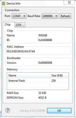

I just started experimenting with JN5168-001-M00 Modules for my master thesis and now I have just the same problem. At first I can read the Device Info like shown and everything is fine

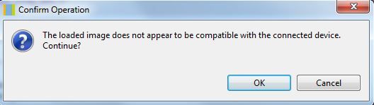

But when I want to program I get the warning "The loaded image does not appear to be compatible with the connected device. Continue?"
If I program anyway the Device Info can't be read out anymore.

Make sure you're flashing it with "jn5168" binary not "jn5169"

Thank you for your answer David. Actually this caused the warning message... Sorry I'm just getting into it :smileyhappy:
Furthermore I found out that the re-progamming issue had something to do with a pull-down resistor I used to set the device into programming mode. After connecting SPIMISO directly to GND without the resistor it just works fine. Seems like there is a small current flowing from the pin in programming Mode leading to a voltage drop over the pull-down resistor, high enough to keep the device from getting into programming mode
